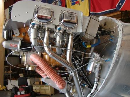

Re: Exhaust system
This is what I fabed. Bought components from one of the aircraft exhust companies.

Re: Exhaust system
Post by ejsflyinlow »
Thanks for the response. Looks nice! Do you guys think it is too loud without a muffler? Where did you purchase your components? Thanks Eric

Re: Exhaust system
Purchased parts from Aircraft Exhaust Inc. Have not flown yet - but sitting in pit with engine running does not seem to loud. Most sound is directed under the plane.
